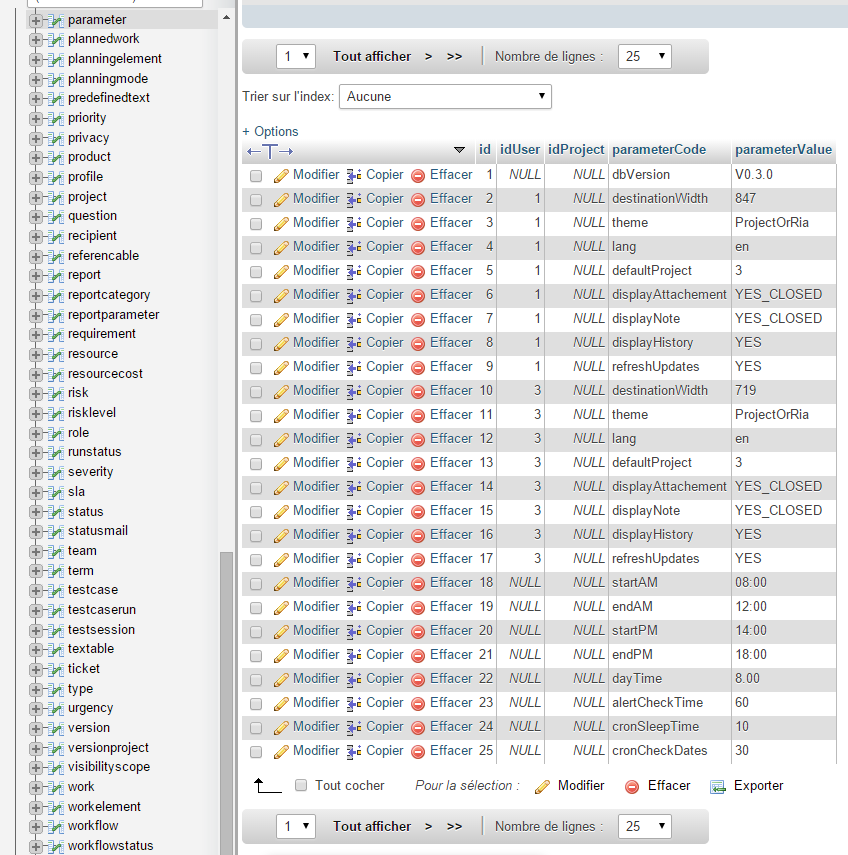

31 Jul 2015 08:45 #3 by bletual
thanks a lot for your answer.
Yes, I really not understand what happens here.
More details about my system : Intel core i7 with 16 GB RAM and a Seagate Barracuda 7200.14 SATA 6Gb/s.
I join logs and details about parameters table.
Bruno.
