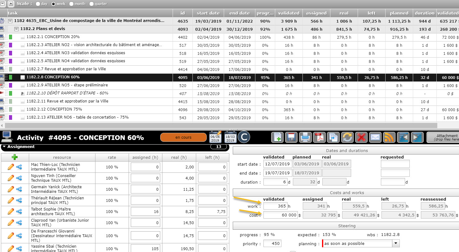

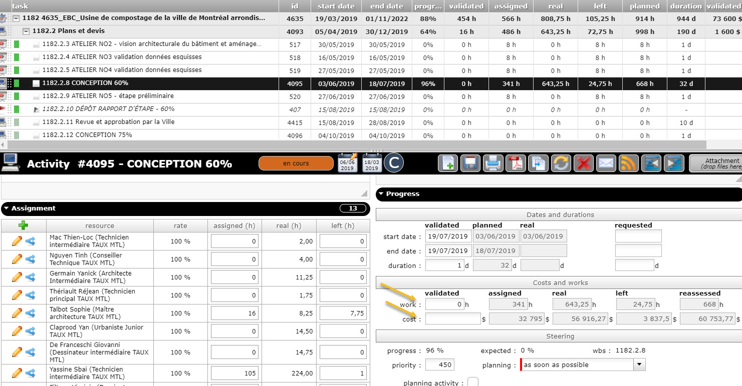

After the update from 8.0.3 to 8.0.6 I lost the Validated Work and Validated Cost in some projet.
Here is an example
Do you have a solution for me

This issue is really major and affects all activiites with validated cost.
To avoid the issue on migration to V8.0.6, after deployment of code change line 797 in db/maintenance.php from
$crit="validatedCost is not null and validatedCost>0";
to
$crit="refType='Milestone' and validatedCost is not null and validatedCost>0";
We'll soon publish a patch to fix the issue.
We'll try and add in the patch a way to retreive lost data.
