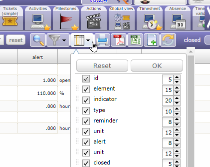

Please, reset the display of the columns organization, (see below)
Regards.

I created an other indicator with same configuration, saving is successfull, but I still cannot see it in the list of indicators.
I reset the columns (which I didn't edit), but same result. the indicator created doesn't appear in the list.
