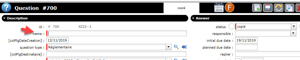

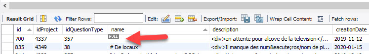

23 Sep 2020 15:07 #5 by karl.binet
Replied by karl.binet on topic Global Planning issue
hi,
I have updated to 8.5.5, having the same issue, but i found out that the version was not the issue.
There was a issue with a question with the ID 700, this questions was copied from another one and for some reason, the field NAME did not follow in the copy and was empty, that was the source of the error
Modify the question by adding a name and now Result in Global Planning are showing.
