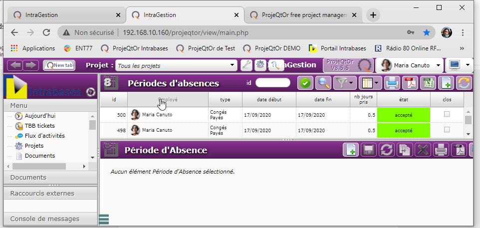

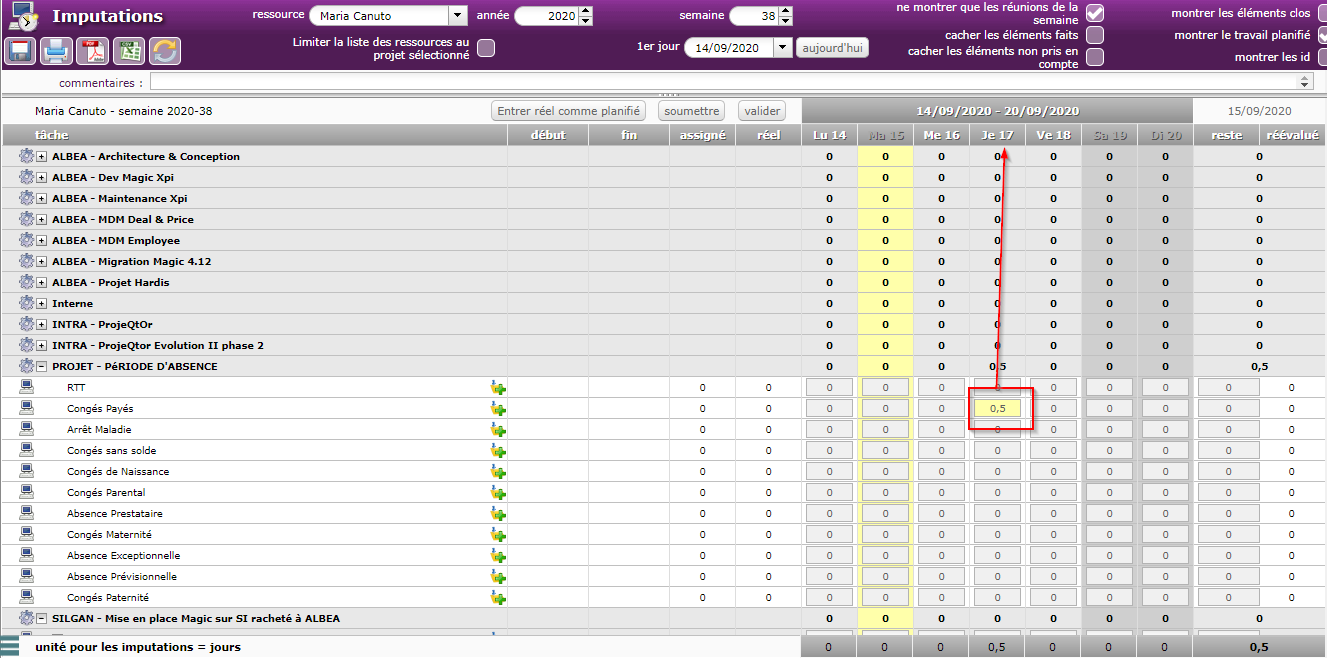

15 Sep 2020 11:00 #3 by mcanuto
just made the test again this morning:
Two leave periods for the date of 17/09:
And on my Timesheet, only 0,5 appears for this date:
I hope with those print screen it will be easier to see my problem.
MCanuto
