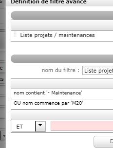

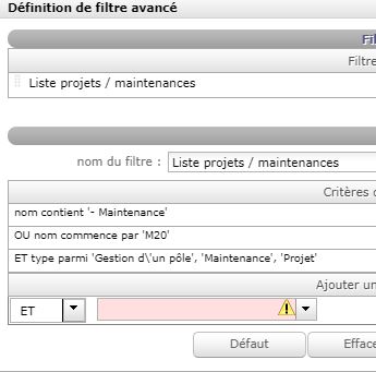

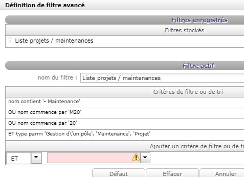

i would like to submit you one issue (projeqtor 8.5.5) with the advanced filter. I created one in the project menu :
When i click to delete the row "ET type parmi 'Getion d\'un pôle','Maintenance','Projet' ", the result is :
the row "OU nom commence par '20'" has been deleted instead the one chosen. If i click one more time to delete "ET type parmi 'Getion d\'un pôle','Maintenance','Projet' ", the result is fine :
30 Sep 2020 19:48 #2 by babynus
Filter is correct.
But you don't take into account priority of AND and OR.
It is like priority of * and +.
Operations are executing depending on precedence, not on order you place them
a + b + c * d = a + b + (c * d) <> (a + b + c) * b
It's the same for AND and OR
a or b or c and d = a or b or (c and d) <> (a or b or c) and d
You expect the last part, and it's not what you get when you concatanate thje conditions
you must write
a and d or b and d or c and d
I know it's a bit weird and long, but without penrenthesis of conditions, it's the only way to get what you expect.
