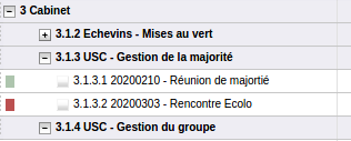

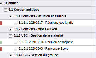

01 Oct 2020 09:05 #1 by Cpt_Jabberwock
We seems to have the same problem on our 2 separate instance of Projeqtor since last update.
This is how it looks when it is all drop down.
This is how it looks when i click on "Cabinet" when it should hide everything (80+ projects)
Some of the users even tell me that some sub-projects they have in this or that projects don't show up when clicking on the + (and the "+" doesn't become a "-" when it is used)
They have all their access when on the project page or tickets and everything else
only the Planning is borked
Could you help me ?

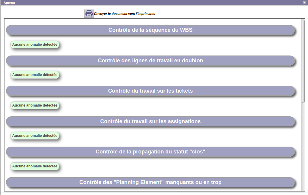

01 Oct 2020 11:41 - 02 Oct 2020 08:54 #3 by Cpt_Jabberwock
It is Green on all sides , even on the second projeqtor (which has the exact same problem)
I really don't know what is causing this problem.
