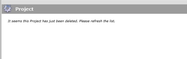

When I tried to copy the project the green notification flashed at the top of the screen like it worked fine and the notification stated that the project was successfully created, with the next (whatever number it flashed) ID (the next project ID). HOWEVER, immediately thereafter, the screen went blank (in the details space) and did not go back to the normal details screen, but showed only a notification that said "It seems this project has just been deleted. Please refresh the list." I've attached a screen print of what the notification was -- EACH time.I tried to copy the project again -- multiple times -- and each time it showed the same success notification, with the same deletion error. I then changed the project type to Template thinking perhaps that would fix it. It didn't. I probably tried to copy the project with multiple settings, etc. 6 to 10 times. I always received the same error.

15 Dec 2020 16:58 #2 by babynus
Sorry, no log attached :(
Please post log file..
Also try and migrate to V8.6.6, latest stable (even if this should not fix your issue)

17 Dec 2020 01:03 #4 by ProjectCompliance
I upgraded to version 8.6.6 (274), latest version, and it appears to have fixed the issue. I copied the project -- and it worked as it should.
