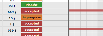

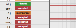

27 Aug 2021 12:10 #13 by CSO_Arnaud
Very strange, may be a configuration problem !!
I perform the test on Chrome and firefox, same result on 3 colleagues station.
I open Browser,
Open Projeqtor (initial zoom 100%)
--> OK
Scroll down zoom to 90%
--> NOK
Scroll down zoom to 80%
--> NOK
Scroll down zoom to 75%
--> OK !!!
If you scroll UP zoom >100% (110%, 130%, etc...)
--> alignement is OK
27 Aug 2021 17:43 #14 by babynus
I could reproduce on Chrome.
I guess it is due to some rounding on browser, that may change trhough version.
Maybe next version of Chrome will get things back.4
I recorded a ticket, but not sure we'll be able to improve this.
So best it to keep browser zoom at 100%, and change windows zooming if required.

13 Oct 2021 17:23 #15 by dcornillon
For your information, I get the same mis alignment with v9.3.1 and Firefox. Zoom was 100% at start up. Zoom in and out doesn't change anything.
It works correctly on Edge.
15 Oct 2021 10:12 #16 by Gautier
Indeed there is an issue, ticket #5772 created and planned for next version.
