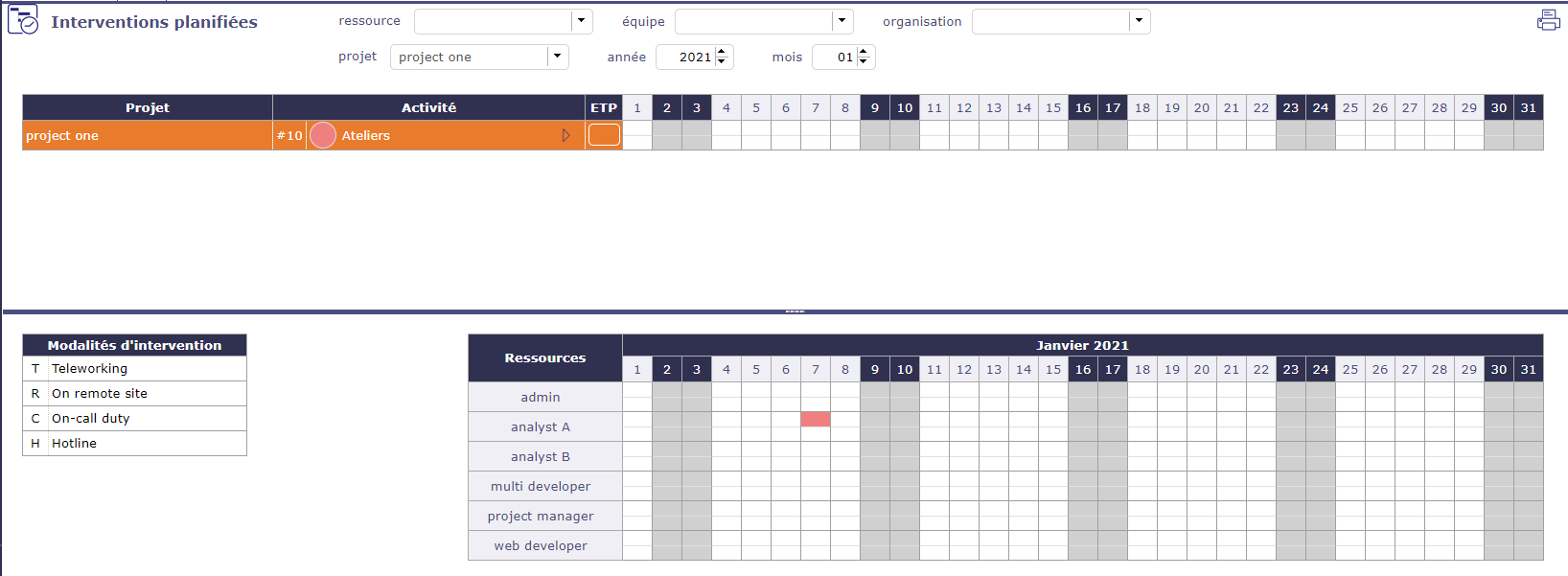

Into Global Parameter / Activity, there is "Manual Planned Interventions enter work as" : "planned" or "real". What does it mean and control?
07 Jan 2021 18:39 #6 by babynus
It's only for planning mode "Manual Planning"
With this planning mode, you use a dedicated screen, with calendar view, to defined work.
This can be "planned work" (that will need to be validated on timesheet) or "real work" (like for absence) depending on the parameter.
