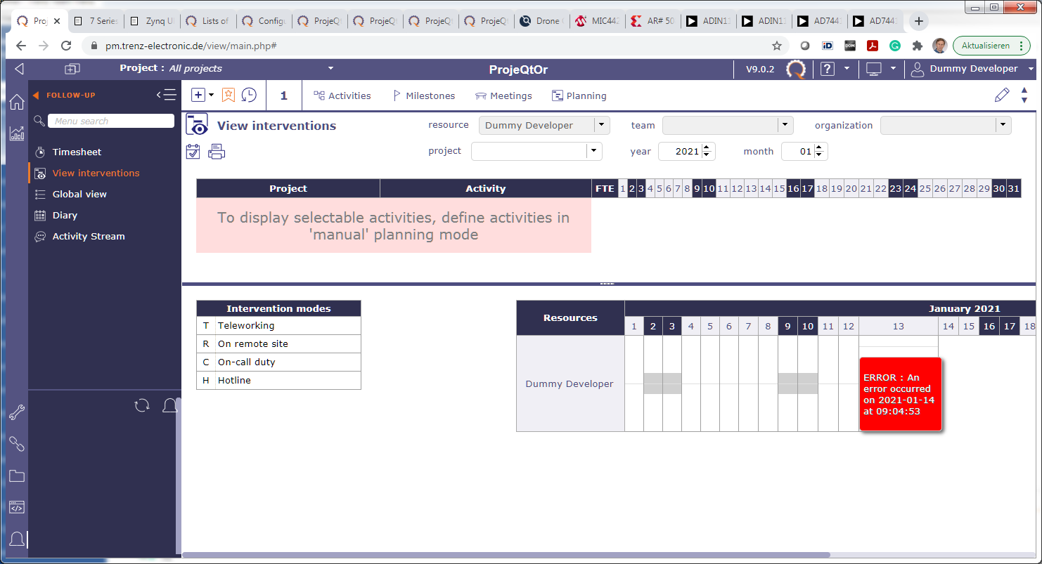

14 Jan 2021 09:14 - 14 Jan 2021 10:02 #3 by alukats
Hi the error comes in 2 cases
pasteboard.co/JJztM92.png
this error happens for all users that have actual work assigned, if I set all work to 0 then the error for given user does not appear, the error comes on FIRST day with assigned work
and in absence view
pasteboard.co/JJzvxeS.png

21 Jan 2021 15:26 - 21 Jan 2021 15:47 #6 by alukats
Db: mariadb 10.3.17 (mysql)
PHP 7.4.8
BUG #1
Additional note this error only happens with old legacy GUI, with new interface it is not coming.
from log:
2021-01-21 15:31:45.106 ***** ERROR ***** [V9.0.2] on file '/var/www/html/pm/htdocs/model/Absence.php' at line (255)
2021-01-21 15:31:45.106 ***** ERROR ***** [V9.0.2] cause = Undefined variable: mediumTextButton
BUG #2
[root@shop logs]# tail projeqtor_20210121.log
2021-01-21 15:22:10.284 ===== TRACE ===== NEW CONNECTED USER 'antti.lukats' (using remember me feature)
2021-01-21 15:22:27.630 ***** ERROR ***** [V9.0.2] ERROR *****
2021-01-21 15:22:27.630 ***** ERROR ***** [V9.0.2] on file '/var/www/html/pm/htdocs/model/PlannedWorkManual.php' at line (346)
2021-01-21 15:22:27.630 ***** ERROR ***** [V9.0.2] cause = Division by zero
this is the line with error
$height=intval($size*($real-$realAdmin)/(($capacity)?$capacity:$resObj->capacity));
a DIRTY fix to:
$height=intval($size*($real-$realAdmin)/max((($capacity)?$capacity:$resObj->capacity),0.1));
fixes the red error ! sure this is not correct fix..
additional note: I have logged to projeqtor from different PC with different language settings, so sometimes comma is , and sometimes its . maybe related somehow?
