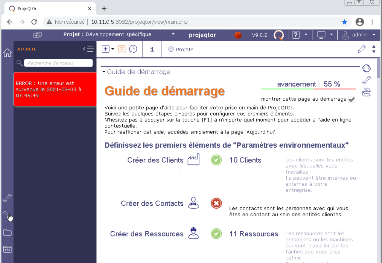

03 Mar 2021 08:52 #1 by yassine.cherif
When I open PojeQtor using our Admin account, we have
ERROR : Une erreur est survenue le 2021-03-03 à 07:45:49
But when we connect with any normal user, everything is OK
Can you help us how to fix this error
Thank you
03 Mar 2021 11:57 #2 by Flou
this is fixed in v9.0.5.
This error it's because you don't have access of a page of our own website on which we retrieve information.
The following user(s) said Thank You: yassine.cherif
