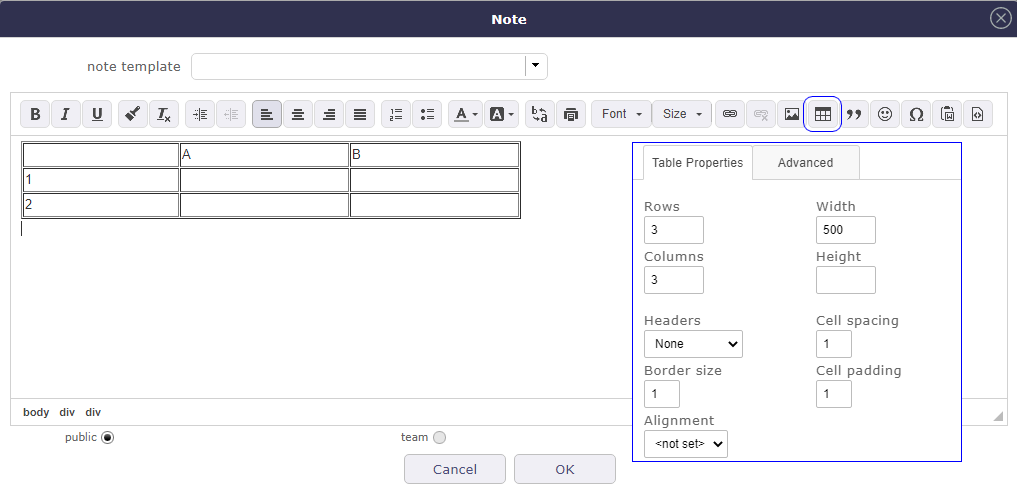

When adding a table in a note, the borders of the table are clearly visible during editing :

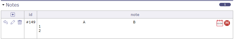

On the other hand, they are no longer so once the note has been recorded :

09 Mar 2021 09:06 #2 by babynus
Replied by babynus on topic Table in the notes
It is the "normal" way web editor works : shows border (double-line borders)
Then, displayed, talbes have no border.
If you want borders you have to specify it is the property of table / cells.
Hint : easy way to include a "formated" table, is to draw it in word, then copy / paste into the note ;)

If I understood correctly, then the borders are invisible by default (represented by a two-line border in the editor) ?
However, even while manipulating the properties of the table (Border size, Border Color), I am unable to make the borders visible outside the editor. It's normal ?

13 Mar 2021 12:48 #4 by babynus
Try style : border: 1px solid black;

This works, but only for the outer border of the table.
CKEditor:
Result:
Is there anything else to add for the interior borders ?
Shouldn't the value entered in "Border size" ("Table Properties" tab) automatically be copied into the "Style" control ("Advanced" tab), as is the case for "Width" for example ?

13 Mar 2021 18:47 #6 by babynus
This is the behavior of the CK Editor.
We don't master it.
To have border on the "inside" you have to define border for each cell...
We'll have a look to set a workaround so that setting border color will be enough to show borders.
