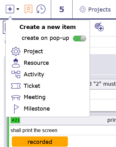

1. I would like to create new actions directly in the Kanban board, but the element "Action" is missing in the menu:

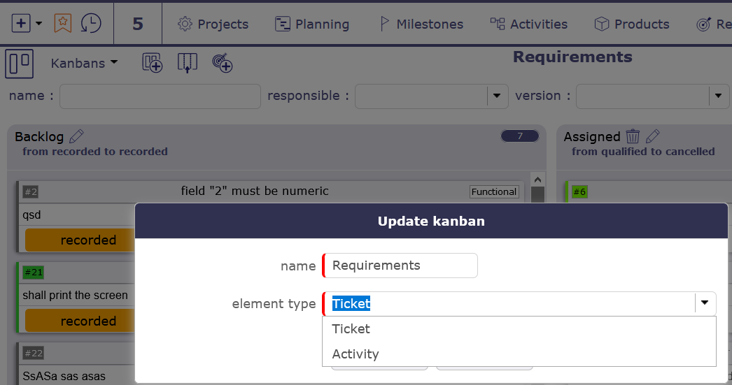

2. I would like to change the type of a Kanban board from Activity to Action, but Action does not show up in the list:
Thank you in advance for your reply!

As for the creation, even with the rights, you are not likely to find the actions in this menu. It only offers the elements most used in ProjeQtOr and planning.
To create your action, you switch to the tools in the list or details area as usual.

21 Apr 2021 11:47 #6 by Arkhanje
Indeed, we had misunderstood that it was about our base and that it was a question of a modification.
And you were right, this is not a rights issue but an anomaly. When modified, the list is incomplete and does not offer all types of kanban.
So we saved ticket # 5459 to correct it.
You can follow its progress on our track database here .
