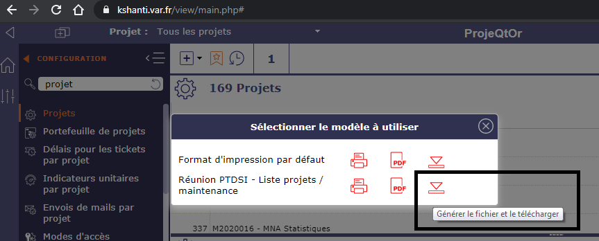

03 May 2021 10:03 #1 by BrunoF782
hello,
we are using the plug-in templateReport (v2.2) and just installed the last version of projeqtor (v9.1.3). When generating a document with the template report
nothing happened (everything was fine before) and the log is :
2021-05-03 09:55:14.312 ***** ERROR ***** [V9.1.3] EXCEPTION *****
2021-05-03 09:55:14.312 ***** ERROR ***** [V9.1.3] on file '/var/www/projeqtor/view/print.php' at line (146)
2021-05-03 09:55:14.312 ***** ERROR ***** [V9.1.3] cause = Call to undefined method TemplateReport::getOutputFileName()
Thanks for your help.

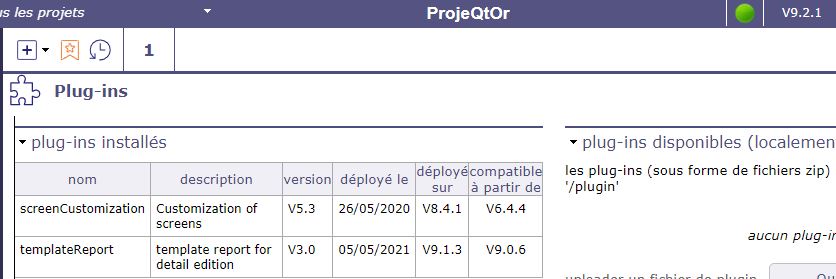

09 Aug 2021 09:20 - 09 Aug 2021 09:42 #4 by BrunoF782
we installed the last version of projeqtor :
and have the issue previoulsy signaled :
2021-08-09 09:12:11.727 ***** ERROR ***** [V9.2.1] ERROR *****
2021-08-09 09:12:11.727 ***** ERROR ***** [V9.2.1] on file '/var/www/projeqtor/view/print.php' at line (146)
2021-08-09 09:12:11.727 ***** ERROR ***** [V9.2.1] cause = Use of undefined constant getOutputFileName - assumed 'getOutputFileName' (this will throw an Error in a future version of PHP)
It is written that the plug-in is deployed on the previous version, do we have to install again the report again to resolve the problem ? (i don't remember having to do that previously)
Thansk for your help.
