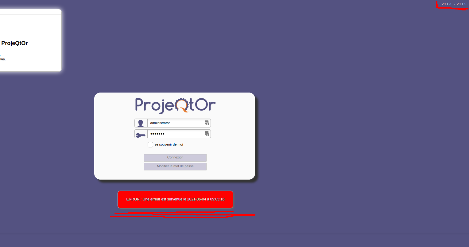

04 Jun 2021 09:08 #1 by Cpt_Jabberwock
For some reason, we have a problem on our Projeqtor since 9.1.3
We have done absolutely nothing in changing anything file related, or something that would pose problem (in our eyes)
But when i tried to update to 9.1.4 (and today, to 9.1.5, because waiting for next update just in case can help), i get the login screen after update like usual, but when i lo with my administrator account to initialise and open the app, i get this:
Do you have any idea what could cause this ?
Are there specific logs we should look into ?
Thank you
04 Jun 2021 14:46 #2 by babynus
Please look at the error log.
You'll have explanation (possibly an access right error)
If you don't understand the error, post it here.

15 Jun 2021 11:29 #6 by babynus
You log file show migration from V8.3.4 to V9.0.6, which ran without issue.
The you have error
2021-06-14 09:32:15.642 ***** ERROR ***** [V9.0.6] cause = ldap_connect(): Could not create session handle: Bad parameter to an ldap routine
It seems your PHP does not undestand new URI format for LDAP connection.
Which version of PHP are you using ?
NB : to fix the issue, just change 1356 in projeqtor/model/UserMain.php from
              if (1) { // New signature
to
              if (0) { // New signature
We searched for compatibility of new signature depending on PHP version but did not find the information.
Please tell us which version of PHP you are using so that we may improve the code.
