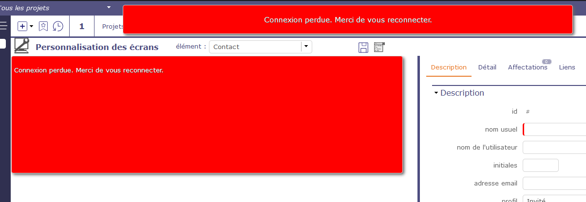

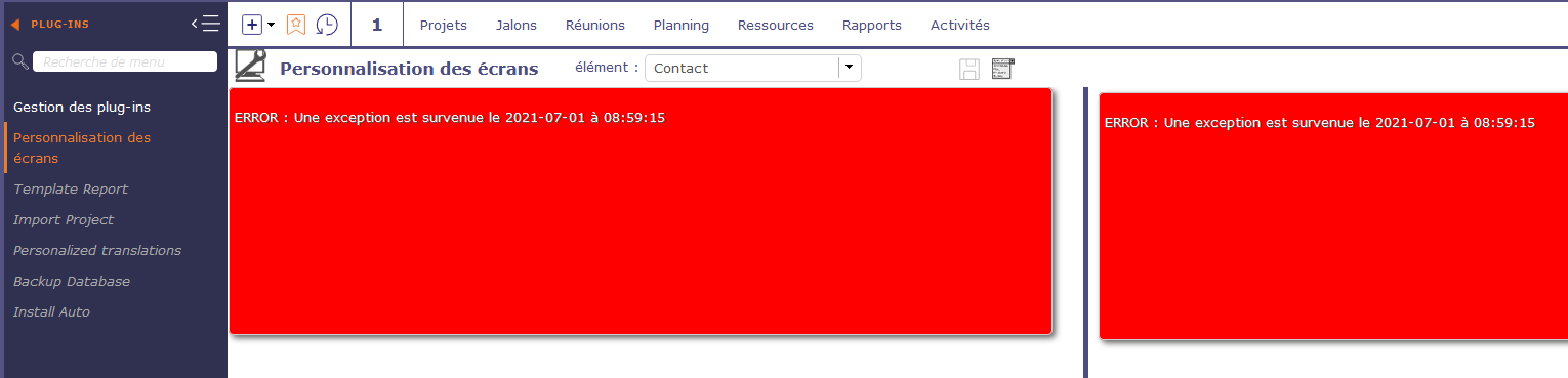

Hello everyone,I have purchased the screen customization plug-in. www.projeqtor.net/en/shop/plugins/screen-customization-detail I have a strange issue when hiding a field in the contact screen. When hiding fax for the example, I have the following error in screen : error_connection, meaning « Connection lost. Please reconnect ».In the log, it displays the following :=10.5pt[Thu Jul 01 07:49:17.248642 2021] [php7:warn] [pid 30078] [client 78.202.160.195:60231] PHP Warning: session_start(): Failed to decode session object. Session has been destroyed in /var/www/projeqtor/tool/projeqtor.php on line 44, referer: rec-projeqtor.yumesolutions.fr/view/main.php
[Thu Jul 01 07:49:17.248702 2021] [php7:error] [pid 30078] [client 78.202.160.195:60231] PHP Parse error: syntax error, unexpected '"fax"' (T_CONSTANT_ENCAPSED_STRING), expecting ')' in /var/www/projeqtor/model/custom/Contact.php on line 93, referer: rec-projeqtor.yumesolutions.fr/view/main.php  When reconnecting and going back to the plug-in page, I have an error message for the contact. I have the same error message in screen when navigating to the contact page. See error-page, the meaning is « ERROR : an exception occured at Date/Time ».In the log the error is the same as previous.How can I overcome this issue ?Thanks for your helpBest regards

05 Jul 2021 12:33 #4 by babynus
Here is fixed file

08 Jul 2021 14:27 #5 by ileduc
It works ! Thank you
