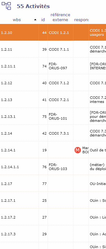

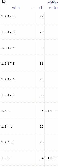

Unfortunately, your suggestion does not solve the problem, as what I am doing to reproduce the behavior is actually clicking on the title of the WBS column.
To illustrate, here are 2 screenshots where you can see that the sorting is actually done according to the WBS title (triangular ascending icon):
  • the 1st screenshot shows that the begining of my activity list starts with WBS 1.2.10
  • the 2nd screenshot is further down in the same list, showing that after WBS 1.2.17.7 there is WBS 1.2.4
In my opinion the correct order shoud be: 1.2.4 then 1.2.10 then 1.2.17.7 For the moment, the sort is: 1.2.10 then 1.2.17.7 then 1.2.4
