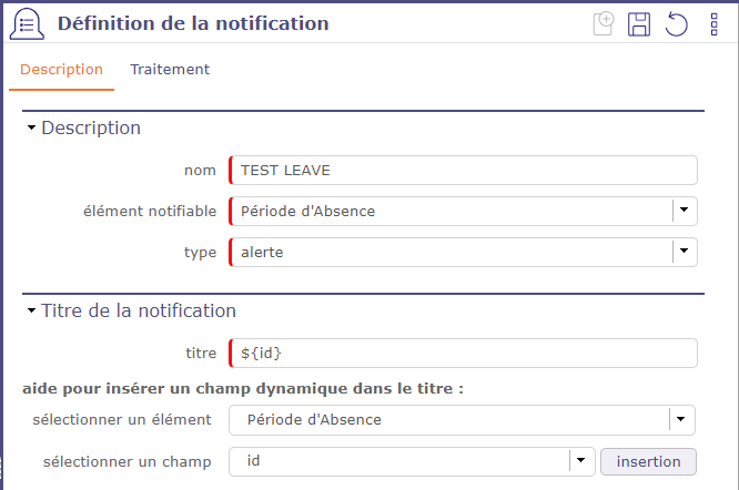

I'd like to generate notifications on Leave periods, to alert that a leave period approaches but it is not yet accepted (for instance).

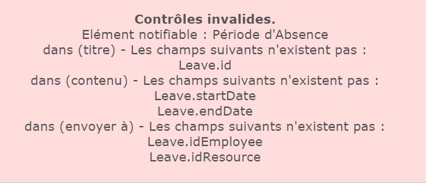

The issue is that when I save the notification definition, I get this error:
I'm trying this under the version 9.2.2.
Can you tell me what am I doing wrong?
MCanuto

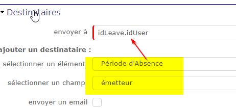

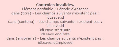

10 Sep 2021 09:34 - 10 Sep 2021 09:38 #3 by mcanuto
Hello, Babynus,
This fields are the ones added by default, when we use the help to insert a field:
I tried to change them manually, afterwards, but I still get an error:
I even tried changing to employeeleaveperiod (as the name of the table), but it didn't work either.
Is there another way to do it?
MCanuto

14 Sep 2021 17:38 #4 by babynus
I don't know what you are doing wrong, but on my side I get the correct code : ${id}

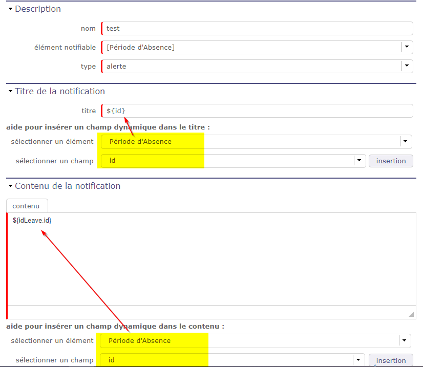

14 Sep 2021 18:01 #5 by mcanuto
Hello, Babynus,
Maybe my problem is because I don't have the element "Période d'Absence", I only have "[Période d'Absence]". It's not really the same thing, is it?
In the tilte, it seems ok, but in the content, not so much:
And on the email destination neither:
MCanuto
14 Sep 2021 18:04 #6 by babynus
I think you have some issue in your talbe "notifiable".
Just check it contents (you may compare with same table on brand new install)
