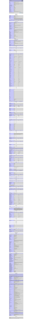

The impacted database has been erased and replaced with a "no prefix" one, which works fine. But, anyway, except the prefix it may have the same parameters than the parameters.txt attached.  Yes, it' utf-8.
