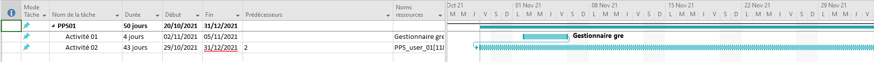

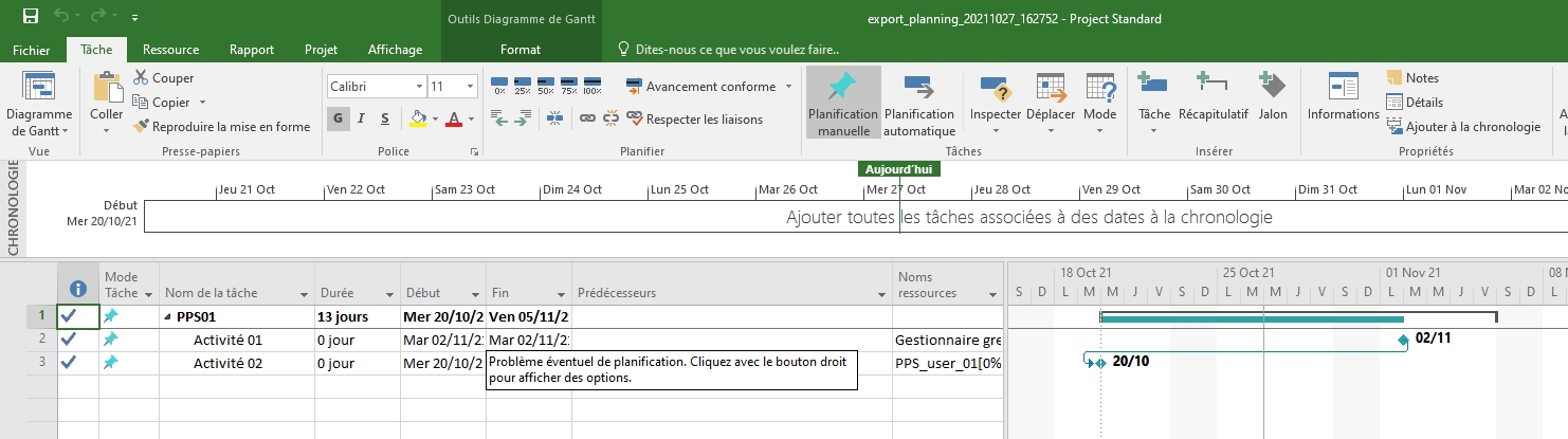

In your demo database, project PPS01:
Export the planning in MS Project xlm leads to the attached result.
Seems to be a problem with task duration.
The duration exported format is not correct: should be an integer: (see docs.NotAllowedScript617ab919e0205micros...=project-client-2016)
<DurationFormat>
IntegerValue
</DurationFormat>
Exported: <Duration>PT8H0M0S</Duration>
Thanks in advance

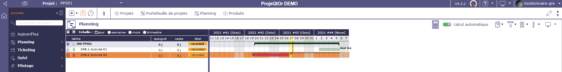

29 Oct 2021 11:16 #8 by babynus
There is no issue with <DurationFormat> tag : if always contain an integer (7 ou 21)
tag <Duration> is then not an integer, as it depends on DurationFormat
What is strange is that when I open the xml with MS-Project 2019, all is fine, I mean I get same planning as on projeqtor.
So is it difficult to tell if it is a projeqtor issue or an MS-Project issue ?
