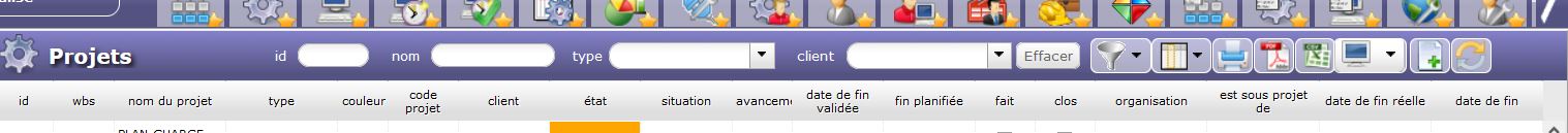

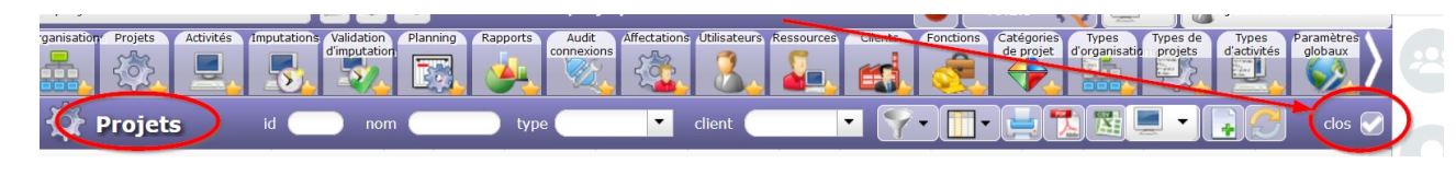

In the "projects" screen there used to be a box "Clos" allowing il checked  to include closed projects in the displayed project list : see attached file "before.jpg"
now the box isn't here anymore ( see attached file "now.jpg") and I cannot get projeqtor to include the closed projects in the displayed project list : so I cannot acces the closed projects anymore !!

Yes, it is something that was weird in users mind : bafore V9.4, as a project leader, if you go to project screen, you could see all "non closed" projects, and "closed" checkbox was here. But switching it not did not show closed project, for one reason ; when you close project, you loose acces to it (your allocation is also closed).
To see "closed" projects, you have to select the "archive" mode (in project selector toolbox). Then "closed" switch appears, switched on.
But for Admin profile, the switch could be usefull, as it works as expected, so we'll show it again for admin profile on future version.

Meanwhile I had found another workaround : in the user parameters set "montrer les éléments clos par défaut " to "Yes" : then the box is here again
