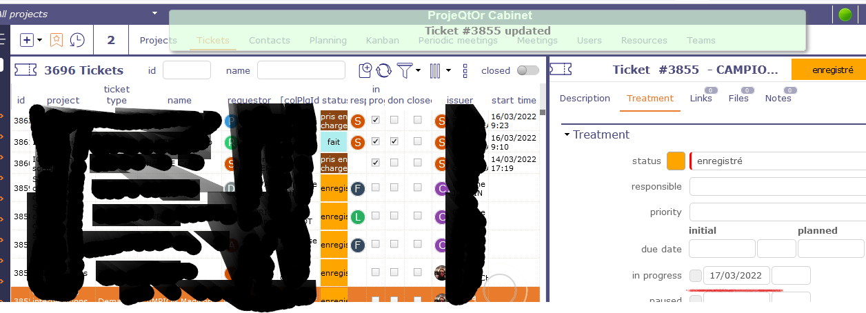

It should update the date (without specified hour, it should be 00:00) but it doesn't even if it says ticket x updated

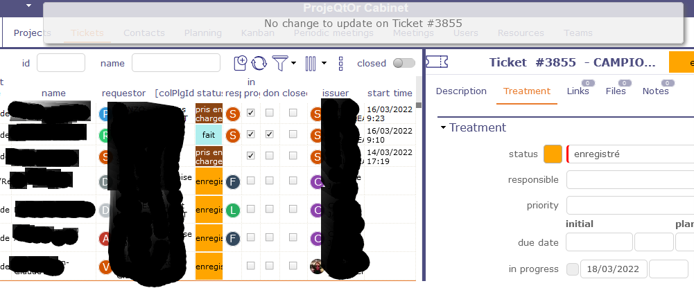

If i try to change the date to anything else:
It says it didn't update since there is no data change
