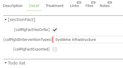

13 May 2022 16:12 #1 by AMAZ
I have customised the "Ticket" screen, in order to add a "facturation" section. (With customisation plugin)
The field "[colPIgFactYesOrNo]" is a boolean that is by default set at "on".
No problem with this field that we use on a daily basis.
But when I want to copy an Action into a Ticket, I have the following error :
"Invalid controls.
value of field [colFactYesOrNo]='on' is not a valid numeric"
Do you have any idea of what's wrong and how I could do ?
Thanks in advance for your help,
Best Regards,
Anaïs
13 May 2022 17:46 #2 by babynus
You should set default value to 1, as boolean possible values are 0 or 1.
13 May 2022 17:56 #3 by AMAZ
But in customisation plug in, I cannot set "1" as default value for a boolean, it does not work and makes an error message ("1" is not valid value for a boolean).
In documentation, I have found that the default value for a boolean is "on" an in fact, it works.
It is just this copy from action to tikcte that produces the bug...
15 May 2022 22:42 #4 by babynus
Indeed, there seem to be an issue.
'on' is the correct value to have the interface work, but is not a good value for copy.
We'll bring some fix.
