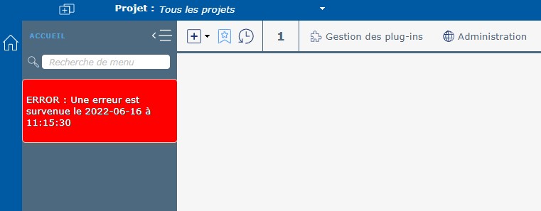

I'm testing upgrade of my server to PHP 8.1, and after connection I get an error when displaying the left-side menu.
**** ERROR ***** [V9.5.5] on file '/projeqtor/view/menuNewGuiLeft.php' at line (677)
***** ERROR ***** [V9.5.5] cause = ucfirst(): Passing null to parameter #1 ($string) of type string is deprecated
Is there a solution for this ?

16 Jun 2022 13:09 #3 by caccia
Unfortunately I'm still getting an error.
I updated to add some names everywhere, and now it seems both 'username' and full name' are ok :
But still the same error
