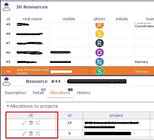

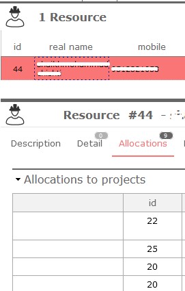

Hi expert,After upgrading version from 10.0.2 to 10.0.3, "Replace the allocated resource" feature not showing!Please refer the attached SS "resourceallocationreplacement.jpg" which has been taken from version 10.0.2, "resource allocation replacement 10_0_3.jpg" which has been taken from version 10.0.3.

Look at same project, you'll see the buttons.
You will just not see the buttons if you don't have rights to update the allocations of the project (not your project or project is closed)

I am already using administrator rights.
08 Aug 2022 09:57 #4 by Arkhanje
this is your default profile. If you are only a Team member or project manager on this project, you lose your administrator rights on this project
08 Aug 2022 10:40 #5 by chandrashekhar
you are right, but I am working in resource module, not in any project.

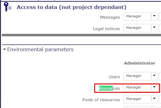

Resolved the issue by changing rights "manager" from "reader" in environment parameters. Please refer attachment.
