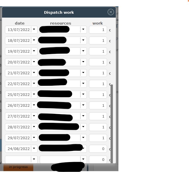

1. The Tickets "dispatch work" window if it has many rows, is missing the ok / cancel buttons, so user cannot save new inputs.

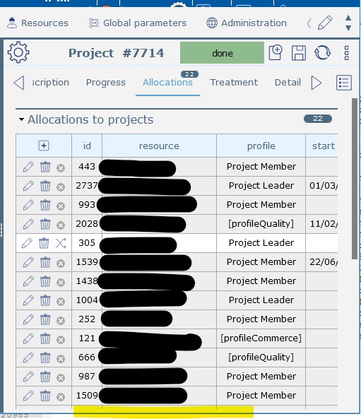

2. In a Project details view, the Allocations list can be cut off on the right hand side, and no horizontal scroll bar is available. Seems to be dependent on the length of the persons' names (?), as this was seen only on some projects, even with the small screen size.

1) dispatch work issue
Ticket recorded
2) Allocations list issue : difficult to do better without setting the mess for all users with "correct " devise.
User should consider increasing detail width, possibly closing left menu.
You can also consider changing Profile names to allow word wrapping and possibly resource names (also to allow wrapping)

Sounds like a good compromise, that's good for me :)
