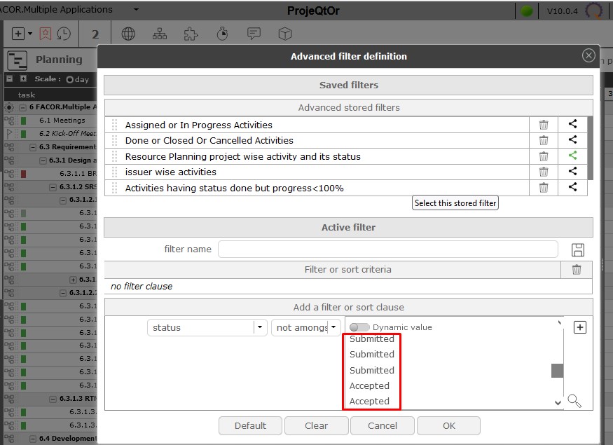

Hi Expert,
Filter using time duplicate values showing in drop down lists as per highlighted in image attached.

impossible to reproduce.
Test on demo.projeqtor to see if the problem persists.
Clear your cache just in case and test if the problem persists on another browser.
and Try to attach your logs systematically when you have an anomaly.

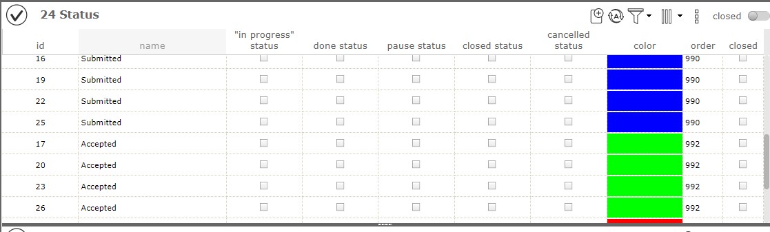

Hi Expert,
I followed the steps you suggested, but when I checked status, it was found duplication for status: submitted, rejected, accepted !
I don't know how it's duplicated!
I think you may help me to find that when and how it happened.
I doubt, it's happening through adding new workflow.
Please refer attachment.

30 Aug 2022 20:03 #4 by babynus
You get duplicated list of statuses.
Try and delete duplicates.
31 Aug 2022 14:23 #5 by chandrashekhar
Yes, I will remove duplicate statuses, I was interested to know, how it happened?!
31 Aug 2022 14:27 #6 by babynus
You surely did something wrong...
... duplicate first install
... export / import of statuses
... play with the DB
Only you (and mayby God, but I'm not sure) can know what went wrond are there is no spontaneous generation in the DB.
