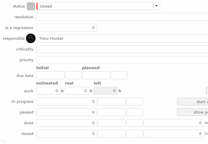

 After moving our projeqtor instance to docker and updating from 10.0.2 to 10.0.3 we have a few issues with the user interface.
  1. In Ticket Treatment the progress flags are displayed as number fields instead of checkboxes
  2. Changing a ticket status does not update the bottom flags
First it is a very bas idea to have technical migration (move to docker) and functional migration at the same time : you won't know where issues come from.
Then, your issues are DB issues, it seems you did not crrectly reimport database to docker (possibly comments on columns have not been imported)

The database did transfer the comments, but I noticed that the data types are different between the current system and a new installation. Many numeric columns are using bigint or integer instead of numeric. I have created a script with the schema diff tool in pgadmin and tried it on a copy of our current system. The checkboxes have returned and are now automatically set when the status changes. I'm going to apply the script to our main system tomorrow.

Changing the column types fixed most of the issues we had, now we have just one remaining.
