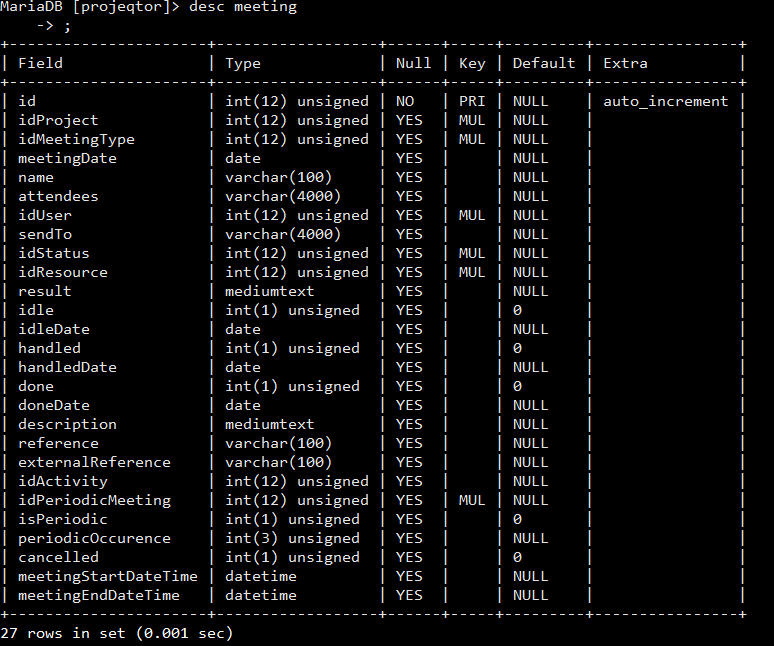

02 Sep 2022 12:12 #2 by babynus
Possibly you have an issue ion the description of this table.
Please post DESC for table meeting
02 Sep 2022 12:16 - 02 Sep 2022 12:19 #3 by surfingjack

02 Sep 2022 14:31 #4 by babynus
Very strange, you don't have all columns expected on table meeting.
What is your DB / Version ?
Can you try and execute :
ALTER TABLE `meeting` ADD COLUMN meetingStartTime time,
ADD COLUMN meetingEndTime time,
ADD COLUMN location varchar(100);
02 Sep 2022 14:34 #5 by surfingjack
I'll try, in fact, Sorry, I was looking the wrong log. I have errors telling these column are missing. I try you script and come back.
02 Sep 2022 14:37 #6 by surfingjack
Hi, OK, it works fine now. thanks. Any idea on why these fields was not created ? was it a wrong way from my side ?
