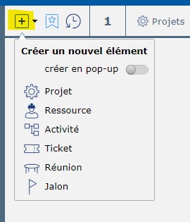

I noticed that when using the "generic" object creation button to create a new project, the reponse time is much slower than when performing the same action directly from within the Project view.
Maybe that can be a small fix for an optimization ?
06 Sep 2022 15:42 #2 by caccia
Extra note: it's the loading of the form that can be long (in a large database). The save itself (after clicking on "save" button) is fast :)

When you create a project through this option, interface will switch to Planning interface to create the project.
So yes, possibly the display of the Planning can be long for database with numerous projects if you did not select a project ot restrict the display.
You'd better use the "pop-up mode" option
