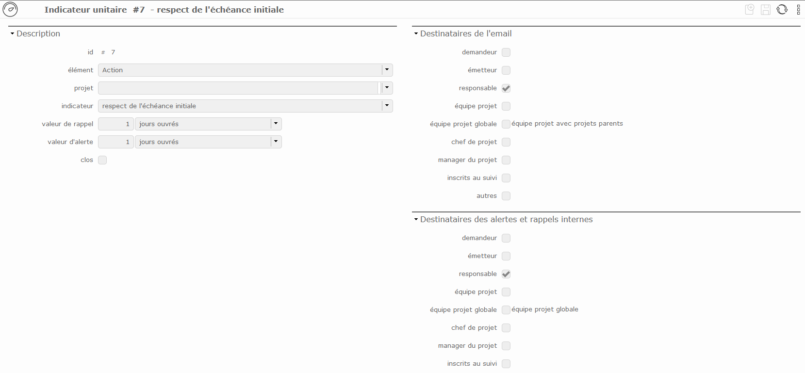

15 Sep 2022 09:20 #5 by babynus
Can you show the definition of your indicator ?
15 Sep 2022 09:59 #6 by matthieu.froment
