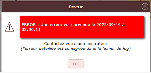

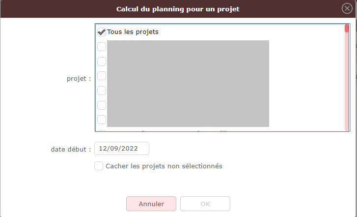

On versions 9.5.5 and 10.0.6, we encounter a problem when calculating schedules when checking "All projects".
In the logs, we have the following error:
2022-09-14 08:00:11.659 ***** ERROR ***** [V10.0.6] ERROR *****
2022-09-14 08:00:11.659 ***** ERROR ***** [V10.0.6] on file '/var/www/html/model/PlannedWork.php' at line (1947)
2022-09-14 08:00:11.659 ***** ERROR ***** [V10.0.6] cause = Undefined property: GlobalPlanningElement::$_profile
We encounter this error with all the profiles authorized to calculate schedules.
If we select one or more projects and sub-projects, we don't get any error.
Thanks for your help

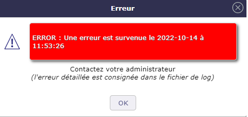

14 Oct 2022 11:57 - 14 Oct 2022 11:58 #4 by alay
On ProjeQtor DEMO, I reproduced the problem with the project "12547-error-planning" (gestionnaire profile).
We have a recurring task (Task A) with an assignment and 2 predecessor milestones:
- Milestone "Jalon A": end-to-end / closed state
- Milestone "Jalon B": end-start
At the planning claculus, we have an error :
In order not to block the DEMO, milestone "Jalon A" has been reopened.
