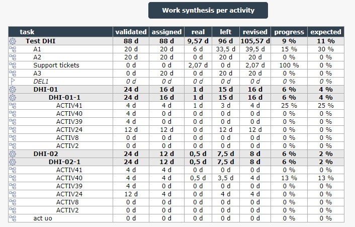

Strange issue I'm hitting : only occurring on some projects, while in others it works fine.
Scenario :
- select a projet
- launch report "Planning > Work synthesis per activity"
- export report to CSV
=> error occurs

16 Nov 2022 12:23 #3 by babynus
We fixed something on that side on V10.1.3.
Please chack if this version fixes your issue.
NB : it was due to some special character (", &, or else) on project name and/or activity name.

Display report :
Export to CSV => error

16 Nov 2022 17:28 #5 by caccia
My apologies - I got the error mentioned above on an old test database. I guess there's been too much playing around in there , data may be corrupted.
I just tested again on a copy of production data, and it works fine. Thanks !
