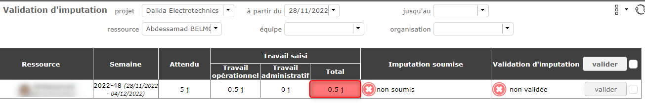

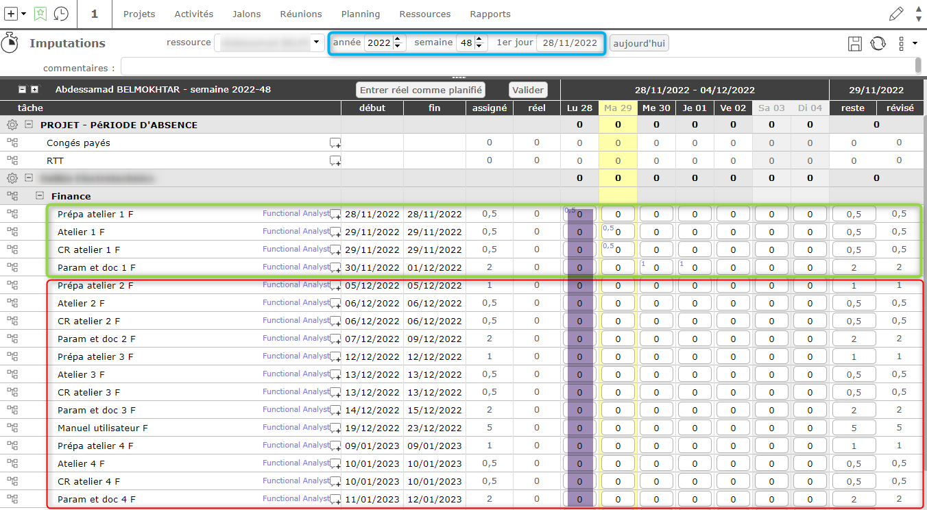

I can't test on demo environment because with guest user, i have no rigth to create activity and timesheet.In the Timesheet screen (Timesheet.png) on the first line table, you see for the date 28 november there is nothing time entry
But in the Timesheet validation screen (Timesheet validation.png) we see there is a time entry for 0.5 day.
As activity is deleted, it not possible to remove this time entry.

I detected another problem (i think). In the Timesheet, normally the lines we can see are just the activity planned on the week we selected to filter data but in here we see activities schedule in futur weeks.
In the screenshot of the timesheet, in blue the entered criteria, in green the activity lines that normally we should see and in red the activity lines that should not be displayed because they do not correspond to the selected week.
The purple color corresponds to the entry of the visible times for the resource at 28/11.

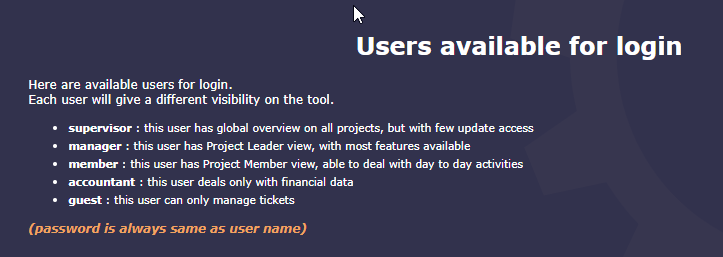

as Babynus said, on the login page we offer you several profiles

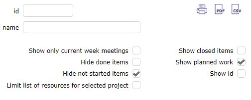

You can in the allocation sheet tools hide the elements which are not started yet.
