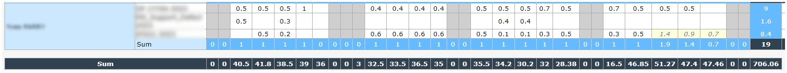

- monthly planning resource/project :
   - total for resource "YP" = 19 d
   - total on project = 706.06 d

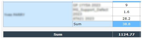

- yearly planning resource/project (only looking at the month of April) :
   - total for resource "YP" = 38.8 d
   - total on project = 1124.77 d

Yes, there is difference.
Monthly view is a detail day by day.
So if on that dat there is real work, this value is taken in account, otherwise planned work is taken into account.
Yearly view is a global view, where same detail cannot be applied.
So displayed value = Real +  Planned.
So if you did not recelculate the planning, this view is wrong, is duplicated some data where real work was entered differently from planned work.
