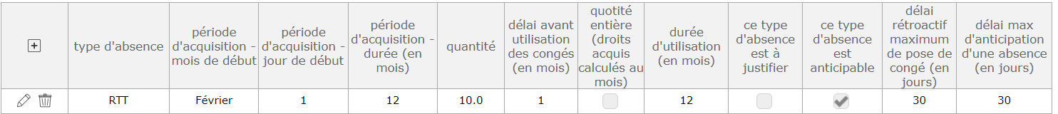

I defined on the Contrat this leave type :
And every month, on the first day, the increment should be of 0,83day, but I get this:

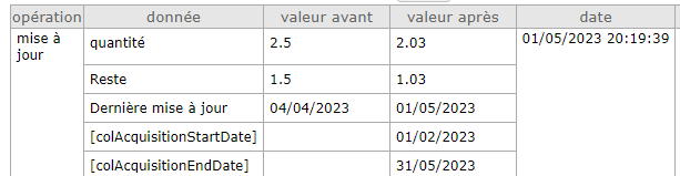

The difference is not the same for every employee, but can you help me figure out why this is happening and how to fix it? I have to manually adjust the leave credit, and when I don't do it right away on the first day, this causes some troubles.

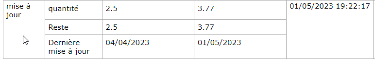

I'm using version 10.1.4, but in our Test Instance (version 10.2.3), the phenomenon is even more awkward:
Thank you for any help.
MCanuto
