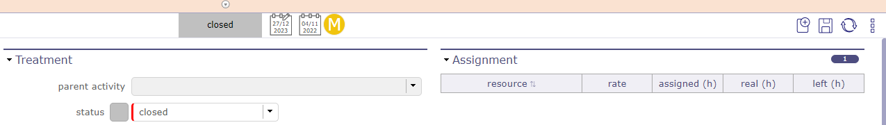

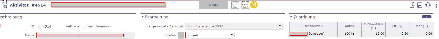

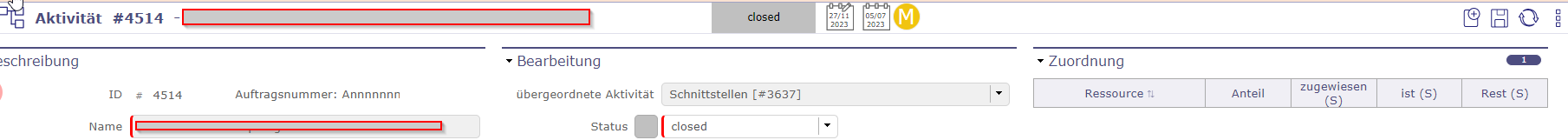

we are actually using v11.0.2 (checked changelog of actual version but found nothing) and are encountering the following problem:
Two users, having same Profile (Administrator) and both are not part of the relevant project - but in opening the details of a closed activity,
the list of assigned ressources differs. One gets the list of assigned ressources and the other gets no information (see attached screenshots).
Do you have an idea on what might be wrong?

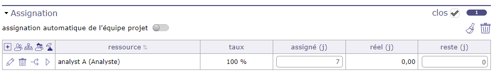

12 Jan 2024 08:52 #2 by babynus
What version are you using ?
Issue is that you should see a "show closed" button.
When Activity is closed, its assignmments are also closed. Logic.
So one use should have opetion on and other off.

23 Jan 2024 19:05 - 24 Jan 2024 00:04 #5 by tblanken
I'm sorry to write you again ;-)
The problem is, that the checkbox you mention is not available (see first attached screenshot).
Cause my problem still exists, I just updated to actual version 11.1.3, but nothing changed.

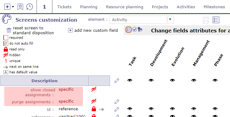

What I've found is some strange setting in plugin "ScreenCustomization" (see second attached creenshot).
Because of having a lot of activities and intensively using custom fields, I can't simply try a reset to standard disposition ...
If this is the reason why we don't see the checkbox (and I assume so) - I would be happy, if there is any chance
to get it back into correct position.

30 Jan 2024 15:31 #6 by babynus
It is just that your activity is closed.
You cannot update a closed activity.
