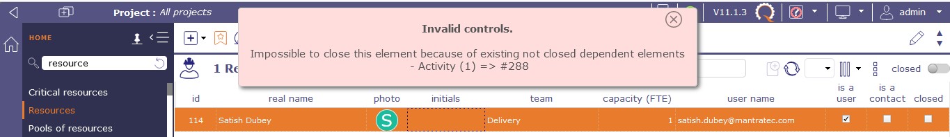

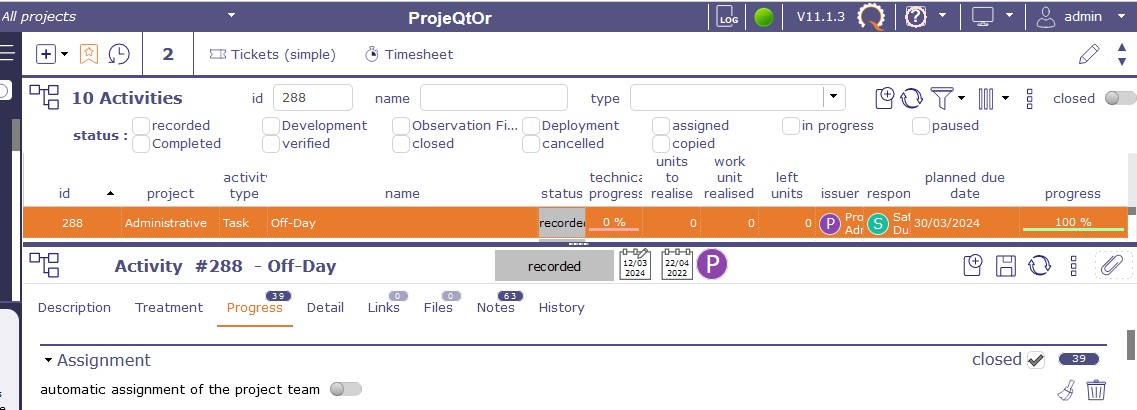

As I want to close the resource following save after adding close date and marking close (refer the "resource closed.jpg" attached herewith), system is showing message asking to close dependent activity #288, when I checked activity #288, I can't find that resource there to close!
Could you please assist me to resolve this?
26 Mar 2024 18:37 #2 by babynus
Replied by babynus on topic Resource close time issue.
You must not close the activity, but change the responsible of the activity.
You cannot have a non closed activity with a responsible that is closed.

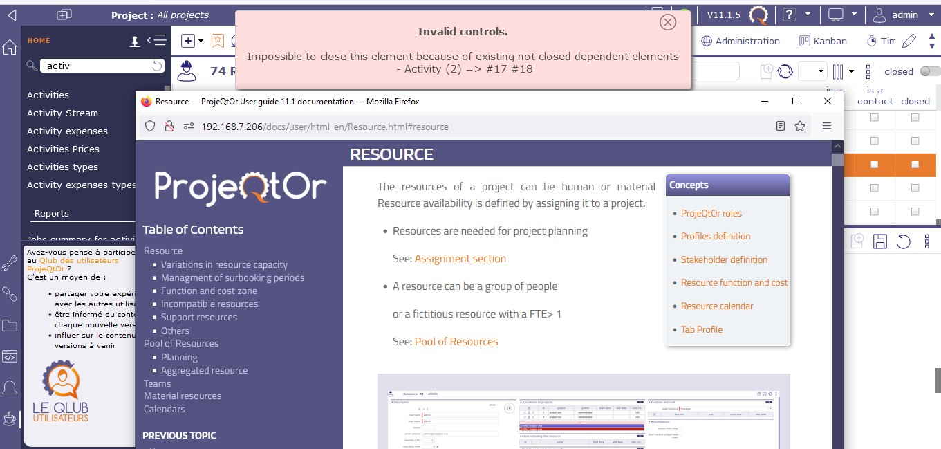

04 Apr 2024 12:32 #5 by chandrashekhar
Thank you for your suggestion. I followed step F1, but unfortunately, I still don't understand. I also tried searching for the phrases 'invalid control' and 'Resource close' within the help manual. Could you please take a look?
