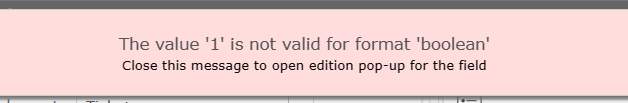

26 Apr 2024 11:04 #3 by AMAZ
Thank you for your answer, but "1" or "0" does not work. The system only accepts "on" and "off"...
