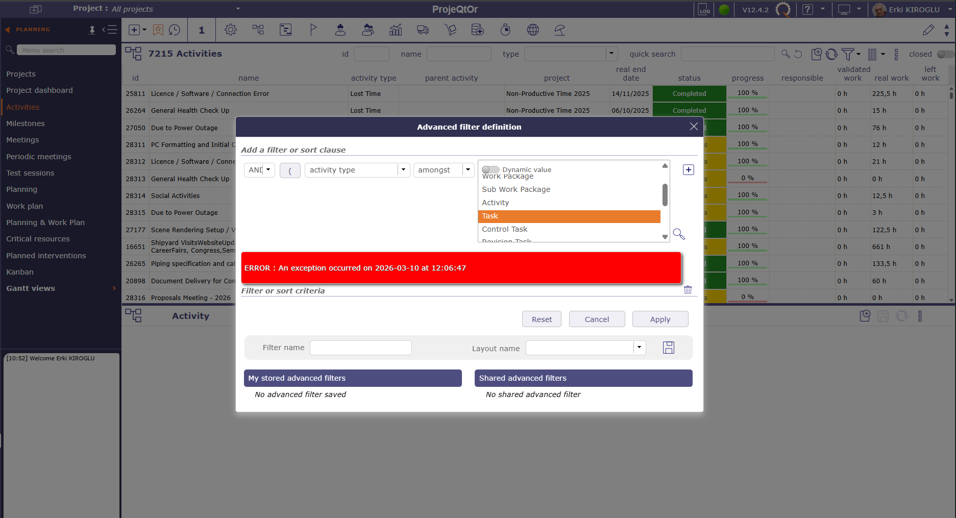

10 Mar 2026 10:20 #1 by ekiroglu
We cannot use Advanced Filter property since after we upgraded to version 12. When i press the plus button in Advanced Filter Definition form for example from Activities section, it generates exception error. I looked at the log file and found this:
2026-03-10 10:36:39.241 ***** ERROR ***** [V12.4.2] [1] EXCEPTION *****
2026-03-10 10:36:39.242 ***** ERROR ***** [V12.4.2] [1] on file 'C:\Program Files (x86)\EasyPHP-Devserver-17\eds-www\projeqtor\tool\html.php' at line (2273)
2026-03-10 10:36:39.243 ***** ERROR ***** [V12.4.2] [1] cause = Call to undefined function array_key_last()
2026-03-10 10:36:39.243 ***** ERROR ***** [V12.4.2] [1]    => #0 C:\Program Files (x86)\EasyPHP-Devserver-17\eds-www\projeqtor\tool\addFilterClause.php (569) -> htmlDisplayFilterCriteria()
Thank you in advance

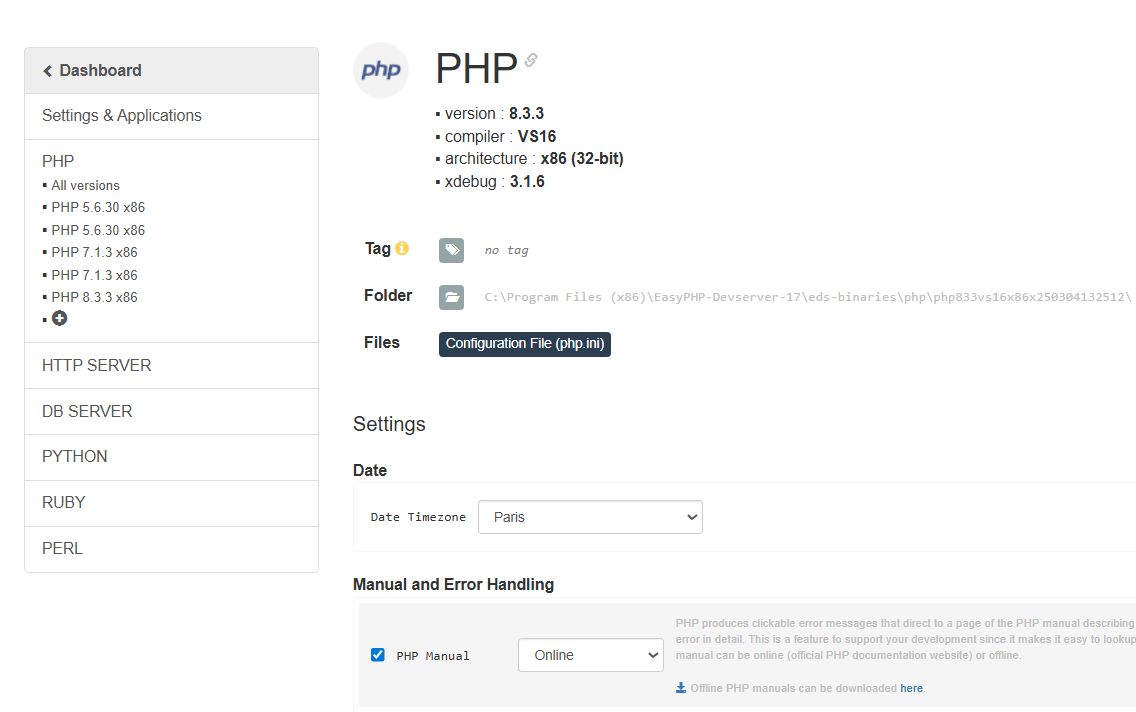

13 Mar 2026 12:01 #3 by ekiroglu
Our PHP installation is like this. Can you help us?
Thanks in advance.

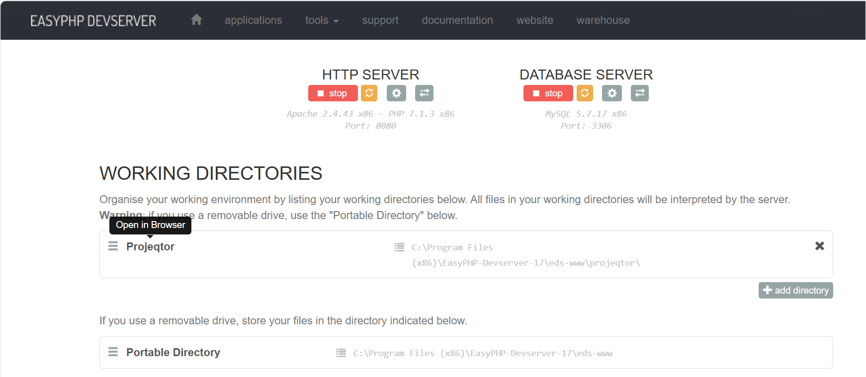

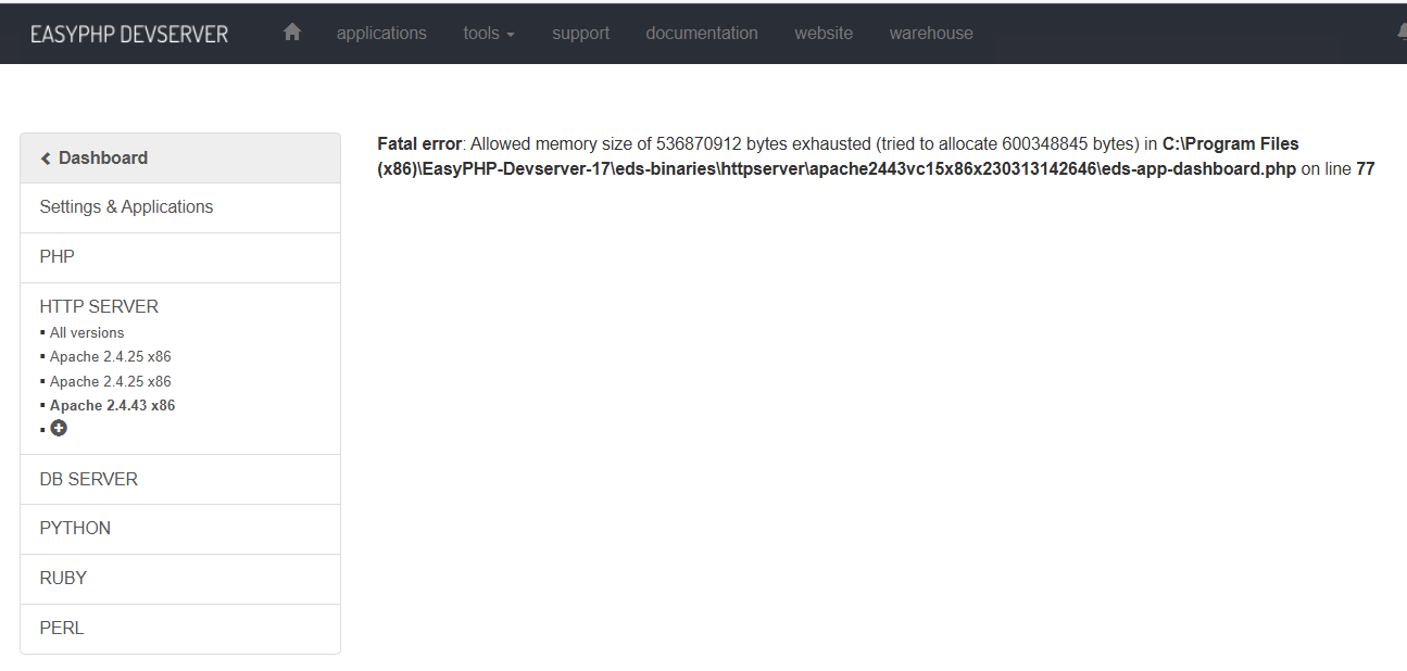

16 Mar 2026 11:57 - 16 Mar 2026 12:22 #5 by ekiroglu
Hello again,
On the main screen it is written as Apache 2.4.43 x86, but in the server configuration screen when i select that server it produces an error like Fatal error: Allowed memory size of 536870912 bytes exhausted (tried to allocate 600348845 bytes) in C:\Program Files (x86)\EasyPHP-Devserver-17\eds-binaries\httpserver\apache2443vc15x86x230313142646\eds-app-dashboard.php on line 77.
The whole system works fine except advanced filter property.
Thanks you a lot.

18 Mar 2026 14:59 #6 by ekiroglu
Hi again,
Server's configuration section look like this
Thanks in advance
