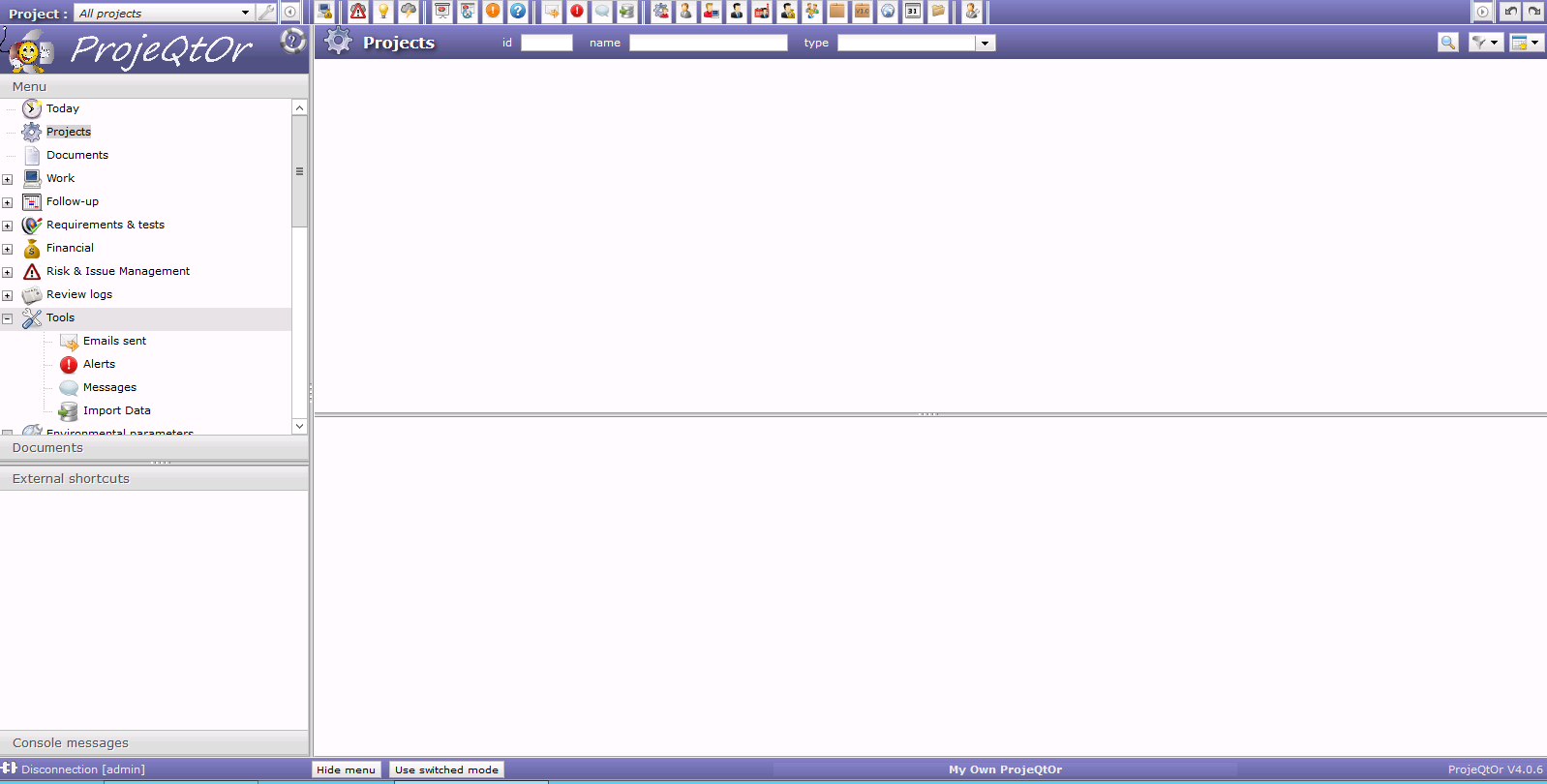

I installed a new CentOS server.
Here is my configurations:
projeqtor v4.0.6
centos 6.5 64bit
httpd 2.2
php 5.3
mysql 5.1
I don't have a taskbar for create a new item (see in attachment). I reinstall several times (x5) and I have the same error...
When I installed on Debian server I don't have any problem.
Can you help me please.
Thanks in advance..

It is probably an missing php module.
First check for requirement, as defined in the README file :
PHP configuration advised :
register_globals = Off ; securite advise
magic_quotes_gpc = off ; security advise
max_input_vars = 4000 ; must be > 2000 for real work allocation screen
max_execution_time = 30 ; minimum advised
memory_limit = 512M ; minimum advised for PDF generation
file_uploads = On ; to allow attachements and documents management
PHP extensions required :
gd => for reports graphs
imap ==> to retrieve mails to insert replay as notes
mbstring => mandatory. for UTF-8 compatibility
mysql => for default MySql database
mysqli => for default MySql database
openssl => to send mails if smtp access is authentified (with user / password)
pdo_mysql => for default MySql database
pdo_pqsql => if database is PostgreSql
pgsql => if database is PostgreSql
php-xml => for xml parsing
You likely have some error in the log file.
Please report it here.
27 Dec 2013 15:29 #3 by soji
Replied by soji on topic CentOS installation problem
In effect, php-xml module was missing. The problem is resolved.
However I checked with the readme.txt file, It's not rated to install this module.
Can you add the module in readme file.
Thanks a lot babynus
