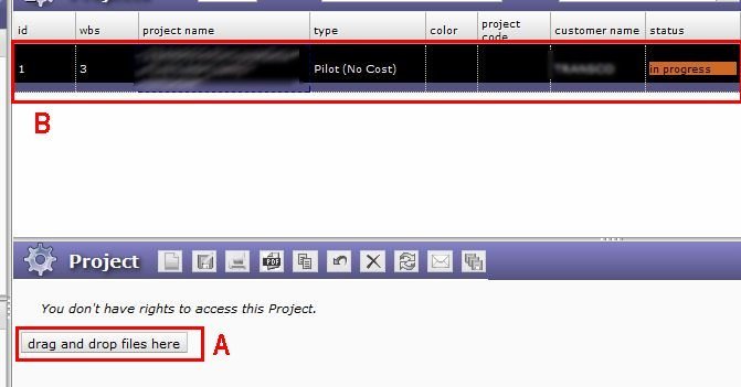

As you see on the attached snapshot location A, when trying to edit the Project in location B with a person with no right access, an upload bottom does appear !!.
I think it should not.
Also the color of the cells selected exhibit strange colors which does not look nice. :S

03 Jul 2014 15:09 #2 by babynus
What is very strange is that if user does not have rights to access the project, it should not be listed in Project list.
Do you have an idea of how you could have this list not empty ?
Some specific configuration ?

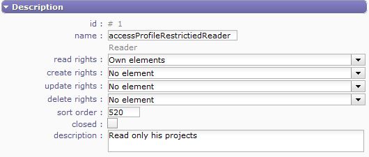

Access to Forms --> Projects
Access Mode Data --> Reader
Reader configuration as detailed below:
04 Jul 2014 23:49 #4 by babynus
I finaly could reproduce.
it happens when user has read acces to "own elements", affected to project and is not manager of project.
Ticket #1426 recorded...
