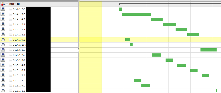

Maybe I got the point. Looking at the picture attached taken from my plan, planned with ASAP, seems dependencies have not been taken into consideration. Looking at table "plannedwork" cames out that activity on gantt start even if no work has been planned for; that should not be.

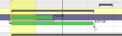

Apart from that, I still have problem with resource allocation I was mentioning. Below picture is taken from the resource planning.
activity 31.4.1.4.3 has 400 of priority, while ALL the other have 500.
Any idea?
03 Oct 2014 16:18 #6 by babynus
About first picture, what can be source of issue :
- planning has not been run on project (check that "fix planning" is not checked and you run planning for this project)
- there is already some real work : so start date is real start date
- dependency has some negative delay that allows second task to run in parallel
About priority of task 31.4.1.4.3, it should be planned before others (as there is no other constraint)
- it really looks like planning has not been run.
Take care that to run planning on a project :
- you must select this project or one of its parents or no project (will run for all) where running planning
- "fix planning" must not be checked (this prohibs change on planning)
- project type is not "Template" (or any project type with code TMP)
If project persist, could you concider anonymising your database and send it to me (This email address is being protected from spambots. You need JavaScript enabled to view it.) ?
