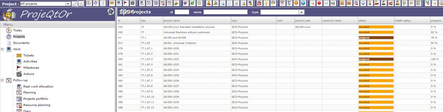

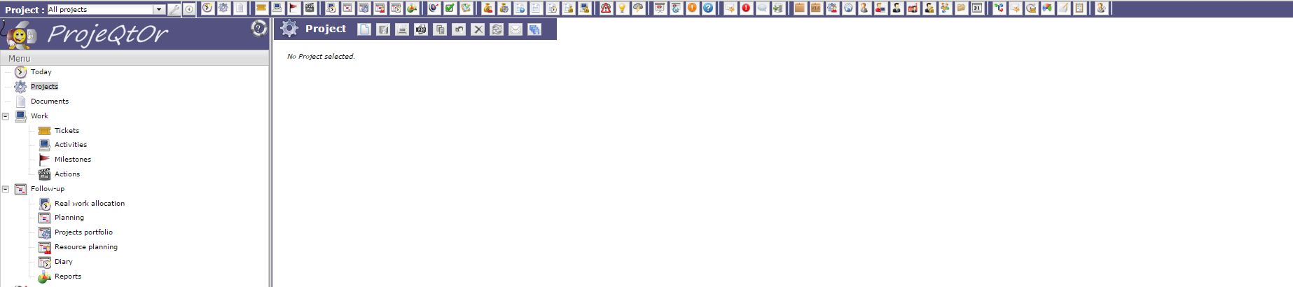

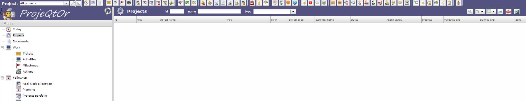

since I am not 100% sure when (I think it is since upgrade to V4.5.x) I have the phenomenon that I don't see projects, activities, etc. (please see attached screenshots).
The Filter selector for the page only appears after moving the browser window (using google chrome Version 40.0.2214.111 m).

Clearing the browser cache has not helped. I do not have this problem in Firefox, so it might have to do with some other setting. As you can see in the first jpeg, the filter menu does not show. It seems that the loading of the page stops before complete loading. just after re-sizing from full screen to window mode, first the menu appears, then I can use the filter...
Additionally the scroll bars (vertical and horizontal) in child windows do not appear until change of window mode.
I connected to the demo site (on demo.projeqtor.org/view/main.php) and have no problems.
Can you think about any server side (php?) settings that could cause this strange behavior?
