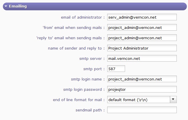

The SSL settings on the server (Apache 2.4) do not allow SSL2 or SSL3 to be used, only TLS - what can be done to ensure that the encryption is only using TLS, not SSL2 or SSL3 as it appears to be doing?
As seen in the attachment, the server name is NOT ssl://mail.verncon.net:587, but mail.verncon.net:587.
The mailserver cannot be changed to add ssl:// as that will break several other functions.
Can the code be changed to remove the automatic addition of "ssl://" to the mailserver string?
