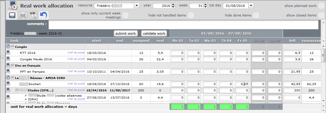

In Real work allocation screen, when I write 0.25 and save it, that is correct. The sum of the day is 1.

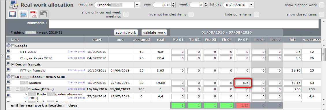

But after refreshing the screen, the value is changed to 0.5 and the sum of the day is 1.25, which is wrong.
How is it possible ?
I try to correct this value, but even after saving, submitting, validating work, it's always change to 0.5.

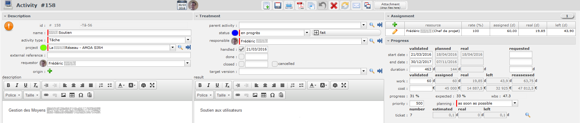

If that can help, here is the main screen of this activity :
