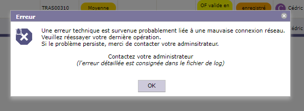

Hi !
I just updated from 6.2.5 to 6.3, and there is a major issue that make projeqtor unusable :
Each time I try to access an element form (example, when I try to open a risk), I got a technical error.
Nothing in log...
Do you already know this issue ?

12 Jul 2017 23:41 #3 by babynus
c.pache wrote: Hi !
Nothing in log...
first, try and clear browser cache.
If problem persists, ckeck for errors in browser console and in apache error log file.
If none shows error, open network tab in browser dev tools, look for last http request and post here response text.

15 Jul 2017 02:02 #5 by babynus
It appears you get some "Error 500".
Please check for errors in projeqtor log file and in apache error log file.
If you are using PHP 5.4 or below, you're probably facing an issue that we've fixed on coming patch V6.3.1
