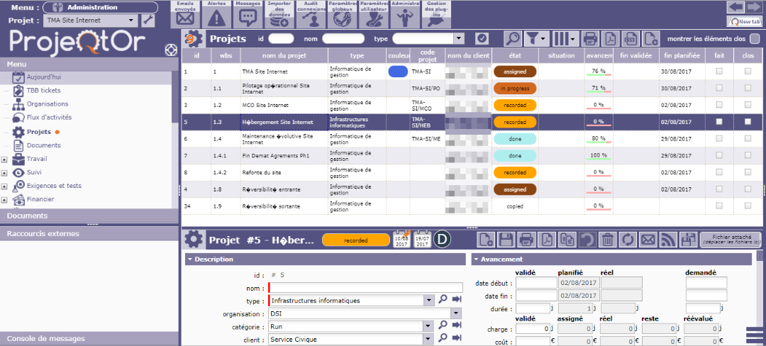

31 Aug 2017 13:18 #1 by Foster
Since the release of the patchs v6.3.3 and upper versions, I've got a problem with text fields which contain accented letters. All the text of the field is hidden.

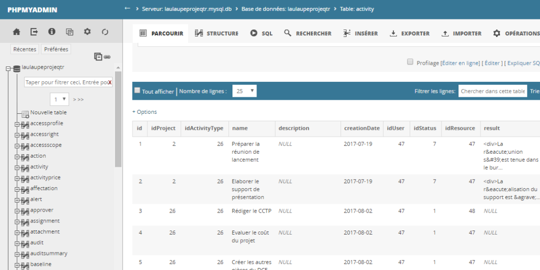

01 Sep 2017 23:25 #3 by Foster
Thank you for your reply and proposed solution. I implemented it but nothing changed. Please find attached flies which showed the problem that happens : as you can notice in the Database screenshot, everything is correct in the "Name" field of the "Project" Table ; all the words using accented letters are correctly dysplayed.
I think that the problem may be fixed up on the application side.
Foster

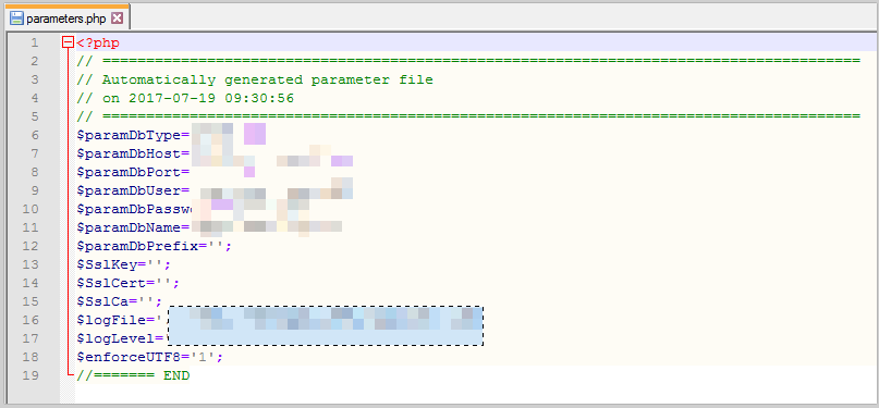

02 Sep 2017 13:32 #4 by babynus
I persiost and sign : it is not the migration that may have brought the issue.
It is the migration process that may have brough the issue : is you changed some parameters, you lay have issue.
For instance, check $enforceUTF8. It must be set to '1' for recent versions, but must not be set or set to '0' if first version is older (before V4.4)
02 Sep 2017 22:47 #5 by Foster
Thank you for your quick reply.
I can tell you that I didn't change anything and the pach installation was performed without any trouble. Furthermore, you can notice in the "Parameters.php" screenshot that the argument called "$enforceUTF8" is set to 1.
Thank you for again I will remain with the version v6.3.2, hoping tha one day I will be able to upgrade to the latest stable.
