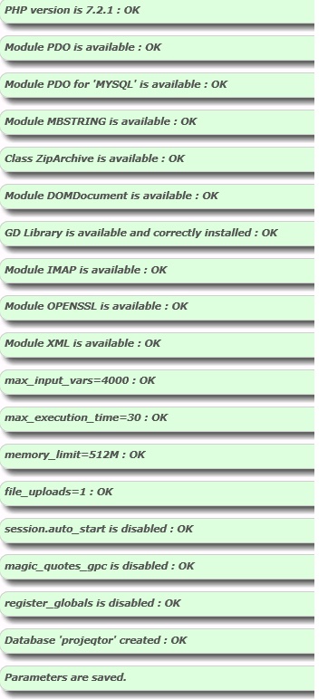

As you can see in the attached file, the configuration looks to be good.

I followed all the prerequisites on the Read Me file, I changed options on the php.ini (wit the extensions needed by the program) and everything was OK (green) when I validated the configuration.

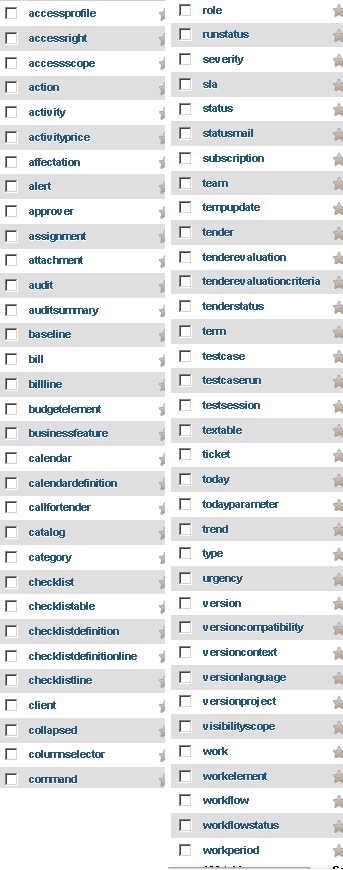

The database is not empty as you can see on the picture attached.
